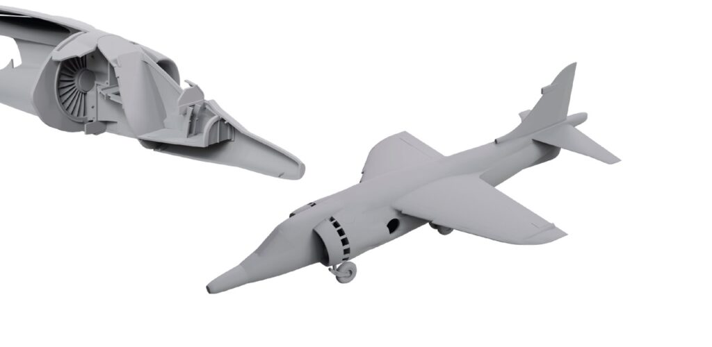

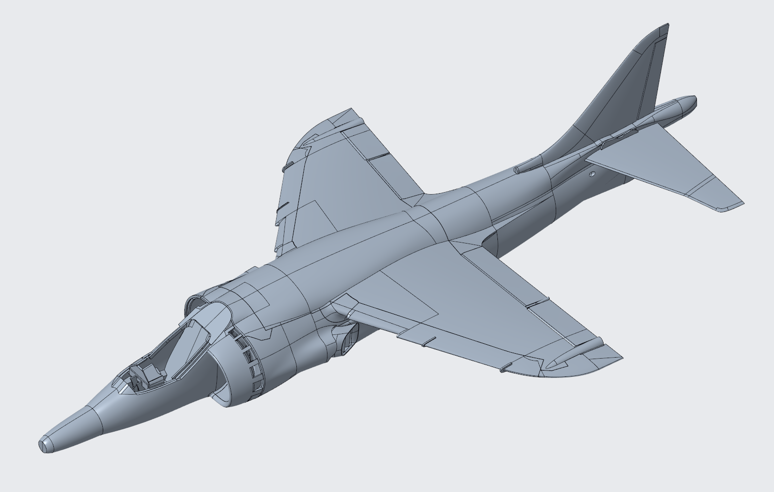

Chris has been working hard on the airframe; originally, we thought this update would be primarily focused on the cockpit detailing stage, but it’s turned out to be a bit of everything this month! Overall, the shape is now near final, with parts having thicknesses added and the model being split into its various parts. The model at this stage looks slightly sparse on the detail front, but this is because there is nothing worse than spending hours/days/weeks adding panel lines, rivets etc only to need to change the overall shape of the part and delete all that work!
Figure 1: Overall Harrier airframe design.

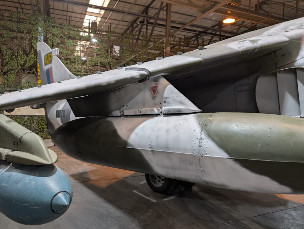

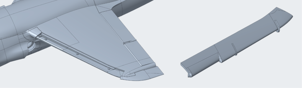

We had some head scratching when it came to the wing, more specifically the vortex generators and wing fence angles. On the real thing, these elements are angled perpendicular to the wing rather than 90 degrees, but this makes it impossible to mould; therefore, most model kits have a slight compromise in this area.
Figure 2: Harrier GR.3 wing with wing fences and vortex generators.
We decided that at 32nd scale that this would be too noticeable and therefore started exploring our options. Around the same time, it was suggested to us that splitting the leading edge would make a modeller’s life easier from a seam/join clean-up perspective. Eureka! We knew we had a solution to two issues; by splitting the leading edge, we can angle it within the mould to allow the vortex generators etc to be moulded correctly whilst also making the build experience better for the model builder.
Figure 3: CAD model with wing fence split into separate part.

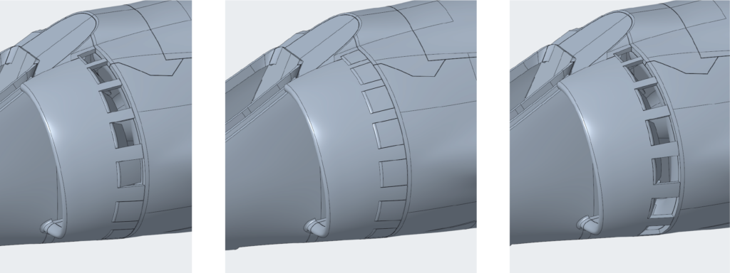

Another area that was ‘fun’ for Chris was the auxiliary intake doors behind the main air intake; each one of these doors is a different shape because having them all the same would be far too easy! Luckily the 3D scan picked up on these door shapes rather well, which made Chris’ life slightly easier; that was until I told him we need to mould them in multiple positions at least.
Unlike most models where we simply design an ‘in-flight’ and ‘on the ground’ configuration, the Harrier has a third which we had to consider: hovering! When on the ground with the engine off, the upper doors sag/flop downwards due to gravity, and the lower doors are flush/shut. In forward flight the doors are all forced shut by the airflow, whereas in the hover they are all open as they are pulled inwards by the suction of the engine. We’ll be offering all three options within the kit.
Figure 4: Auxiliary intake door positions.

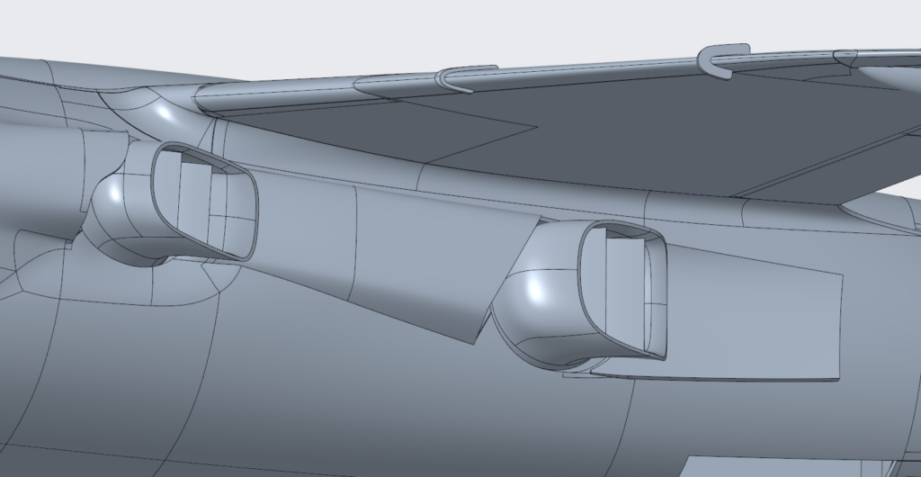

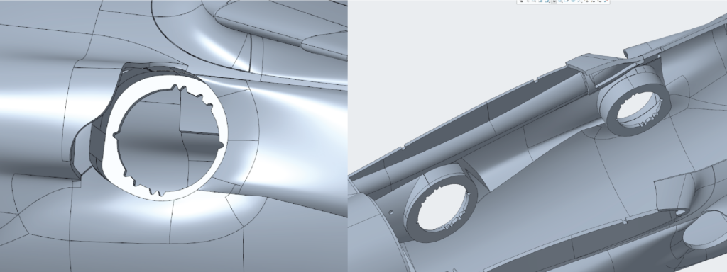

Talking of positions! We had to decide on the best method for setting the thrust nozzles. Some kits leave the location for these parts loose, meaning the modeller has to ‘eyeball’ the position of each one. Others use a linkage position; this means that all 4 are in the same position relative to each other but the angle is still manually set.
After a fair bit of discussion, we elected to ‘fix’ the nozzle positions with a variety of options for the modeller using a series of notches. Whilst this will mean the modeller needs to be sure to manually set each nozzle in the same position, they will be at the correct angle for whatever stage of flight the modeller so chooses. Now, we had to choose which angles to ‘set’ by consulting both the RAF and USMC manuals and decided on the following:
  • Fully forward: For when the aircraft is in forward flight.
  • 10 Degrees: Used for conventional take off.
  • 30 Degrees: Used for Rolling Vertical Take Off (RVTO)
  • 45 Degrees: Between 45 and 60 degrees was used for taxiing.
  • Hover stop: Essentially fully downwards for when displaying the aircraft in the hover.
40 degrees of nozzle was used for some landings, but as you can see this would make the notches simply too close together, and so we elected for the options above. It’s also worth noting that the nozzle angle would also be altered depending on the all-up weight of the aircraft.
Figure 5: Nozzle positioning rings showing the various ‘fixed’ position notches.
Figure 6: Nozzles in place as if in forward flight.

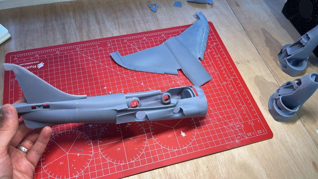

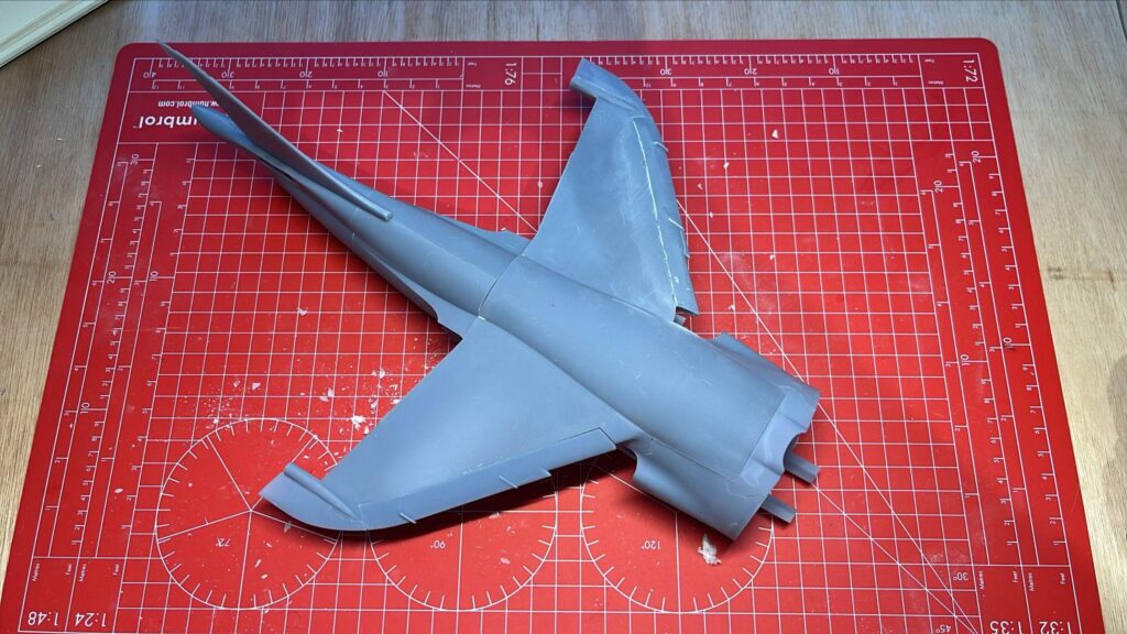

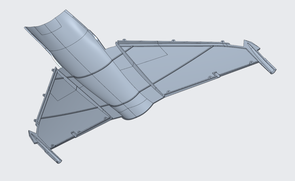

3D printing has proved invaluable to our designers; the ability to print out sub-assemblies to quickly check fit between parts in real life allows for changes to be made throughout the whole design process, leading to an optimised design. Chris recently printed out a rough model of the main Harrier fuselage and wing section to check a few things, this also allows us to get a real sense for the size of the thing! Thankfully, a 1:32 Harrier is not all that large due to its diminutive wingspan.
Figure 7: Test 3D print of the tail, fuselage and wing.
Figure 8: Test 3D print showing the overall size of the model (minus nose).
As a result of the 3D printed tests, Chris was able to identify a few issues and implement a few solutions. One such issue was the wing strength; on the model they were susceptible to crush/deformation when under pressure from clamps, adding ribs across the wing has solved this issue.
Figure 9: Wing after reinforcement added.

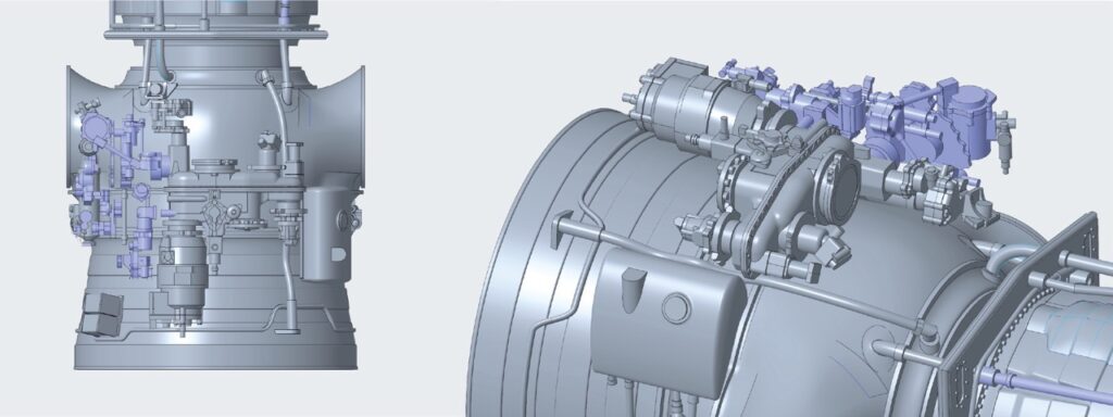

Horatio has been working hard on the Pegasus engine; and one of the more complex areas has proved to be the fuel control system and various bits of piping/wiring. You can see the progress that has occurred since our last update, but Horatio believes that he has another 50% or so to go before calling that area done! There are lots of calls that need to be made regarding feasibility when it comes to the pipework, as some of it is simply too small when made 32 times smaller.
Figure 10: Pegasus engine fuel control system etc.

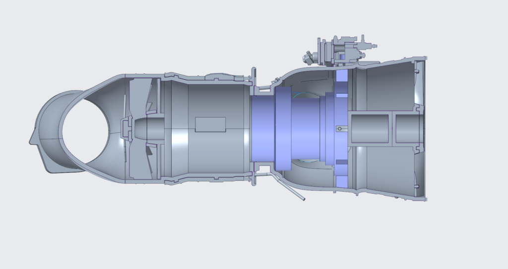

As well as all the ‘bits and bobs’ atop the engine, Horatio has been working hard to detail the inside of the engine. It’s very easy to go down a rabbit hole and start adding unnecessary detail at this point; we therefore have to constantly evaluate whether a part/detail we’re adding is in fact visible. As you can see from our cutaway, we have trimmed a few components out of ours, mainly because it doesn’t need to generate thrust!
Figure 11: Cutaway of our Pegasus engine model.

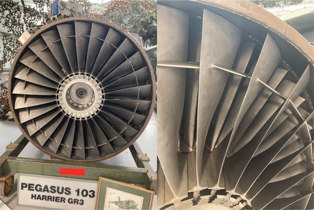

One place we know we need to add more parts is the front intake, where there are multiple layers of fan blades but the model currently only contains 1; we therefore need to add a 2nd set, but anything more feels unnecessary, especially when you take a look at the real thing below:
Figure 12: Front fan blade arrangement of the Pegasus, showing that the second row of blades is visible.

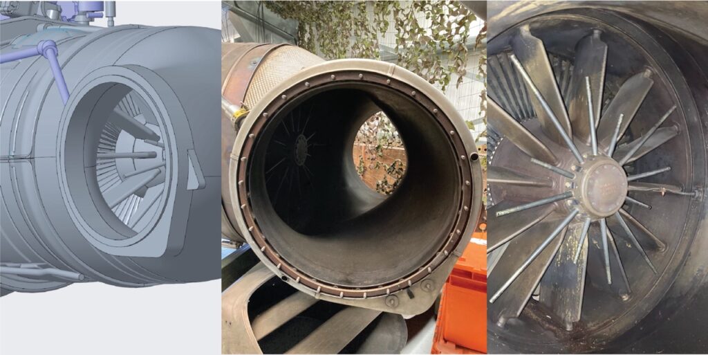

One example of an area with marginal visibility is the rear nozzle apertures; you can just about see some of the components, so we therefore felt we should add them. However, we did debate just how many people will be picking up their engine model to take a look at this exact angle!
Figure 13: Visibility through the rear nozzles of the engine.
